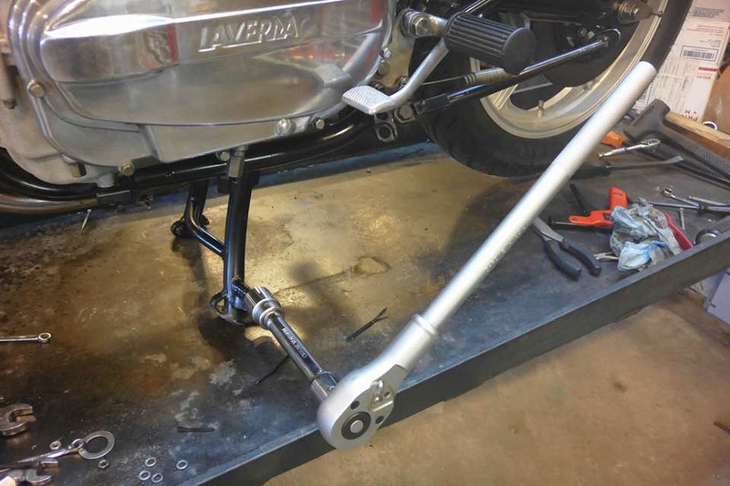

Like many of you, I installed a Kawasaki sidestand kit on my Laverda.
It is perfect exept for the fact that you need to cut the lever of the centerstand when installing it making the centerstand very difficult tu use.
My solution has been to weld a big nut on the remains of the centerstand lever so I can now use a big ratchet to rotate it.
Welding on an old socket to have the square drive would also work, I tought of it after...

Sorry but i'm struggling with this too  :(  how do you steady the bike then operate the ratchet to get it on the stand,must be a knack to it or very awkward,no?
padlock said:
Am i alone in not really understanding this? In order to use the centre stand you have to take a ratchet with you??

If you modify the stand mounting bracket as shown in the links, you should get both stands operating correctly. Well worth the effort!
http://www.laverdaforum.com/forum/index.php/topic,91079.msg294792.html#msg294792
http://www.laverdaforum.com/forum/index.php/topic,89633.msg273867.html#msg273867
It sounds like one of those race stands that seem to need at least 2 people to use or risk having the bike fall over. For all the effort of welding on a nut wouldn't it take the same effort to cut and weld so both can work together?Or do the mod in post 2 above. At least that's possible. After lots of effort fitting a Cagiva Alazzurra sidestand , Pantah by another name, they both swing in the same ark so one must fold past the other to use either.
I used the sidestand for a long time as the only stand for the bike, never had an issue with that. However, I also never had an issue using them together: simply flip out the sidestand first, get off the bike and while you still have the sidestand out, put the bike on the center. Then flip the sidestand back in - all good.
If you first put in the sidestand and then the centerstand, the centerstand lever can be bent to fit around the sidestand. If you want to put the sidestand out, you push the centerstand down, too (a bit) and once the sidestand is 45? out, the centerstand flips back into its riding position. No issue...  ::)
Yes, you have to put the bike on the centerstand then, flip in the sidestand and the center afterwards, else it stands out to much for cornering. I got used to it quite fast and used the sidestand only for getting off the bike easier. Had the 1000 SFC fall off the sidestand twice, never trust a sidestand eversince...
There is a bit of fouling for mine it depends on what order i close - in both cases its a light touch on either - has caused no issue - but i would'nt be without the side stand or the centre stand  - if the centre stand is first there is no fouling - if i want the centre stand i just flick the side stand out and lift onto the centre stand - the Kawasaki stand kit from Joe is 100 times safer than the Corsa suicide stand
