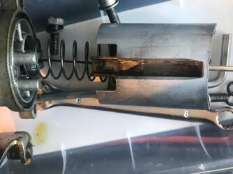

So having got the engine running on three cylinders I took it for a run up the road. That's when I discovered that it didn't like to accelerate. Open the throttle fast and not much would happen, but it would run up through the revs okay on a more gentle throttle. So I reckoned the accelerator pumps needed priming. Did that, but still the same. Took out one of the the throttle slides and found that the operating mechanism for the accelerator pump was entirely missing. Same on all three carbs!
Can anyone give me some hints on which bits I need and where to get them from? I haven't worked on Dellortos before so not sure what the missing parts even look like. Strangely, the carbs have been rebuilt and look like new!
Here's one of the throttle slides with a slot for the missing part.
There is a plastic arm held on with a pin and a tiny spring between said arm and the slide to hold it against the slide. A hell of a lot of people do exactly what you have as they recon they don't do much to help other than waste fuel spraying it needlessly. In my experience they help, my reason is they do increase the effort required to twist the throttle and my old Husky came with a Del as std and it had horrible slow speed control so I thought I would try removing it. The action was lighter but it lost its ability to wheely over obstacles. I put those bits back and lightly lubed that groove the plastic arm ran in and got a great result. Just to end the correct adjustment for the squirt is X twists should result in X millilitres of fuel. I forget the numbers though. BTW check the jetting and carb are synchronized, the accelerator pumps have an effect but it's not huge.
Quite common for the pumps to be deactivated, as Vince said, to lighten the throttle. Opinions are mixed as to the usefulness of them with our bikes at all, except to burn extra fuel, so I wouldn’t waste time with them in relation to your problem.

So the flat mid range response might not be the accelerator pumps. Carbs have all been cleaned and rebuilt with many new parts by a company called JRS. Don't really know what else has been done to the engine as the guy who did most of the work is sadly deceased. I realise that I need to check everything over, but fitting the actuating arms for the accelerator pumps has to be worth a try to see if there's any improvement. It goes pretty well once past that flat spot and at 5000rpm plus, so I think it's unlikely to be cam timing, but could be wrong.

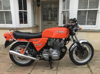

Here's the Mirage:

Well, I have managed to get hold of the missing carb parts from the previous owner and fitted them. He had a box of spares, tools and manuals which he got when he acquired the bike, though he didn't feel any obligation to pass them on to me. Some of this stuff is now listed on ebay...
Anyway, with the accelerator jets now working properly the bike feels much more responsive and accelerates strongly, especially towards the top end of the rev range. A huge difference.
