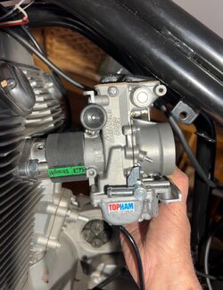

The studs look long because the insulators are not in place. The insulators also have the important o-rings in them. The problem with clearance under the frame rails is a problem with any non-standard carbs or longer inlet manifolds on the SF. The later SFC had the frame pressed in, others have cut and shut the frame rail.
