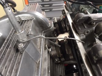

Is this the bracket you are referring to ?
Set of mikuni's fitted with bracket, supplied by Red. Bracket is sturdy.
Treaded adaptor goes into the cam cover, other end onto the bar joining the 3 carbs.
That's also what I have from Red: my carbs were wiggling off the stubs as well. Before that alloy mount was made, we were using heavy-duty plastic cable ties. It's much worse in mt case without the airbox, adding a bit of support. Air filter pods add even more cantilever
Different carbs (not my engine!) but photo shows Red's threaded adaptor which replaces a cam cover allen screw. I fitted a rubber mount on the carb end of the flat strip bracket to minimise vibration effects on my RS36 setup.

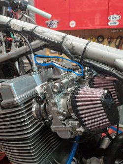

I was up early and made a silver soldered adaptor bolt for the cam box , the special shouldered screw was vfr750 and I used a fairly stiff anti vibration bobbin to isolate the carbs...1000010574.jpg1000010571.jpg
