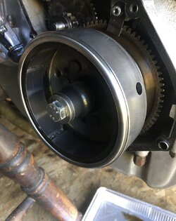

Took the cover off and all looks fine, clean.
So nothing had disintegrated yet!
I’ll spin the starter up on a bench to make sure that’s all ok, I think it will be but I’m checking as I go.
So, I could leave it and hope it was a one off, or think it was a early warning and go ahead and replace springs/plungers & rollers,
Is there a existing thread or is it straightforward ? Been searching the forum but thanks for all and any pointers,
The bolt on the crank looks tight!!!!
Stuart

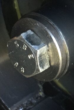

First things first, is this bolt normal or left hand thread? Any particular trick to undoing it? And will a puller be required?
Also, I can see the ends of 3 screws which seems tight,
I assume that removing the rotor will allow the sprag etc to come off, replace springs/rollers possibly plungers,

Courtesy of a certain Mr Keith Nairn:
"1. Remove the bolt in the centre of the rotor. Should be l/h thread but it may be r/h: if there is writing on the bolt head they are r/h, if not they are l/h.
2. You then need an M16 x 1.5 bolt to pop the rotor off its taper. Use the front wheel spindle if you do not have a suitable bolt.
3. Remove the small tab from 12 o’clock on the big gear and withdraw the sprag clutch assembly. Pull it off using the big gear to stop all the springs and rollers popping out all over the floor.
4. Split the two halves on the bench clean and inspect. With a bit of luck a new set of rollers and springs will fix it."
Keith

Brilliant info-thanks,
Just found Patrick’s thread on ILOC, that also helps, noticed he used thread-lock on the crankcase bolt plus the 3 x screws,
I’m not keen on thread lock on something like this and rely on correct torque, but maybe it’s needed here,
So this makes it R/H thread?

Heat’s usually good, but don’t go crazy here because the magnets don’t like it. Rattle gun worked for me, as advised by Legs (as he advised me too, cheers Legs), I used it for both removing the holding bolt and driving in the M16.
Replacement is a bit different and I used a pin spanner etc so I could use a torque wrench.
Also check the little tab for wear. If it breaks off you can do damage so replace it if required (c/o Piet).
