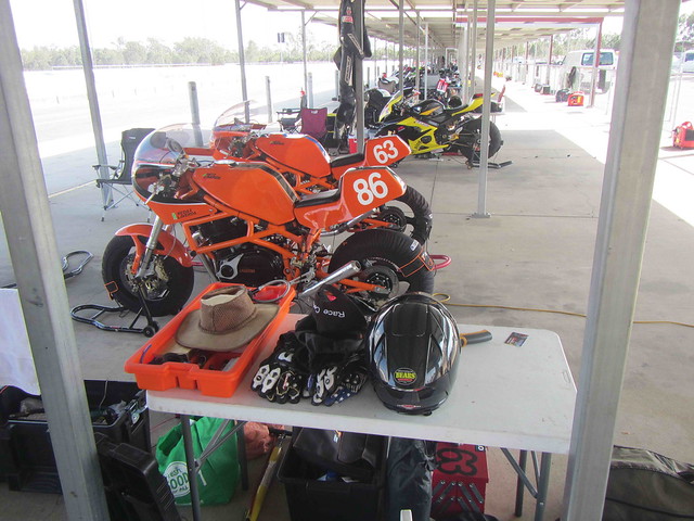

today we took the two girls out for a leisurely ride around QLD Raceway, have a race meeting in 15 days time so had to give them a bit of a run, never went above 9,500 rpm once
needed to cure a small misfire in #63 we picked up in the last race at Philip Island and #86 just needed some heat cycles and quick run in on her fresh engine
top day, great time with Paul and MarkQLD at the track, 3 old farts playing with 2 old clunkers, does not get much better than that
MP Sept
Good on you boys - hope you enjoyed one another's company and that the day was productive.  Certainly looking forward to seeing you in Sydney in a couple of weeks time.
