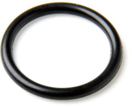

In past ten years, I have replaced clutch slave cylinder piston seal three times. The last one lasted 20000km before starting to leak. So obviously the epdm O-ring I have used (29.74x3.53) isn't a robust solution. Would anybody know a source for better seal for 30mm piston? I belive the original had rectangular cross-section (same as brake piston seals). So, looking for dimensions, product codes or direct online source.

The O ring you quote is a British Standard type and is .25mm under sized, I agree that metric 30mm seals (30 x 3.5) in EPDM are hard to find, (strangley the 31mmx 3.5mm are not) this makes your failure sooner rather than later
BS 217 EPDM 70 is 29.75mm x 3.53mm

Thanks Clem. Cross bar is OK, recently turned 90 degrees. Pushrods and balls were renewed maybe two years ago, so they should be OK as well. Good tip about the O-ring size though. I just checked and 30x3.5 is actually quite easy to find.
