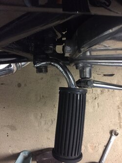

My new to me 1979 3CL seems to have a bent right hand side front foot rest, has someone got a good close up photo of a good original right hand side one so I can compare them to see what needs to be done
A 2kg hammer straightens it quickly. Doesn't hurt the rubber either. Whack it till it looks OK and sort of matches its opposite. Peer over the top and from behind, a couple of mm here or there won't bother you, they're all different to begin with!

I would take the foot rest off the bike a place it in a big vise to straighten it - less you risk damaging the frame.

You won't be able to lift the hammer that is capable of knocking off a triple frame, Ron. The footrest mounts are perhaps the strongest parts on Laverda frames. If you ever try removing one, you might understand...
I use this, admittedly brutal, method often, both on twins and triples. Not once has anything broken or bent, except the footrest in question. It doesn't even damage the rubber! Haven't had any chrome flake off either.
Don't "tap" it, hit it like you mean it! And beware the reciprocating hammer.

I took mine off, in the vice, heated up and bent back with my trusty Thor copper hide- with you all the Ron!

In consideration on how that Foot Peg got bent - Inspect the frame around the mount and ensure nothing is bent or cracked welds.
