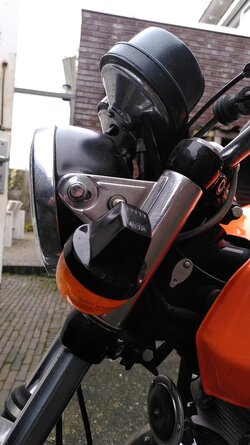

Installed cheap and very brigth mini LED turn indicators from Aliexpress to replace the big (broken) indicators I had. Took a while to figure out how to get them working, the solution turned out te be simple. After replacing the lights I needed to also replace the relay and found this tiny Kellermand R1 relay to be perfect: https://www.louis.nl/artikel/keller...481829769d5973&filter_article_number=10032274. Indicators work, blink at correct speed and the dash control light works. Simply connect the three wires (plus to red, signal to green and dash control to yellow). Three pictures, old indicators before replacement, the almost invisible tiny LED indicators and the connected Kellerman R1 mini-relay.
