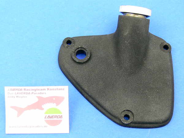

Sick and tired of wobbly, hard to reach funnels that quickly overflowed and dripped surplus oil all over the cases, I searched high and low for a suitable alternative. I finally gave up and made my own, fired up the 3D printer and I got what I wanted...
As I nicked the design online from Thingiverse (search for "skewed funnel) and my CAD abilities are not very far-reaching, the spout turned out a bit too big for the dip stick aperture, so I knocked up an adapter that is screwed into the crankcase and will also hold the funnel firmly in place. Both items made from PLA at 0.15mm layer thickness, so it'll keep the printer busy for a day. I can supply the link to the funnel and .stp file for the adapter if anybody is interested.
I didn't really need it for the 3C as it has the SFC gear selector cover, but the cramped space above the RGS dipstick make filling a Pita. Will probably work OK on SF1> due to the upward angle of the carbs, but VHBs will probably block the funnel, so I'll need a work-around for that.
The angle of the funnel is actually quite a bit further upright than it seems in the pic, teetering on my wonky knees when I photographed it.

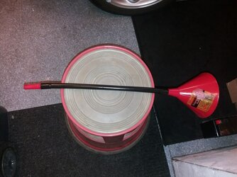

Nice piece of kit, Piet! I've been using a funnel for transmission fluid for the past 30+ years, fits perfect into the oil filler opening.

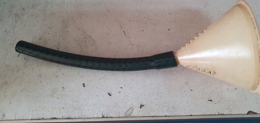

I made this funnel extension from a piece of common old reinforced garden hose, back in 1979 ish. Been using it for every
oil change on the Jota ever since. The SF2 gets it's oil poured through this too. Not rocket science. :ROFLMAO:

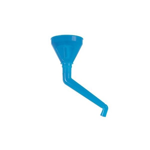

I use this funnel for years and yes, I've also had the experience of it buckling away when the oil level in the funnel adds weight. I always use a fun construction of tension bands between the 3c and a camping chair to hold it in place. In addition to the weight from the oil which has to be taken in account, also the lower fixation is important - it must not slip out of the filling hole at the bottom.
Well, I get along with it, at least it's orange ...

My design does not require any additional support. The fit of the spout in the adapter is quite snug, the printed plastic surprisingly strong. A full funnels' worth of oil is no problem, leaving both hands free to handle oil bottles and a fag or beer can at the same time. ;)
If I were to modify it, I'd try to enlargen the funnel to be able to dump the entire 3 litres at once and perhaps incorporate a venting facility. Flow rate is determined by the crankcase opening, so flow time will be much the same if filling slowly or fast. Dumping all the oil at once gives you a chance to take an extra swig or two from your can without worrying about spillage.
Time will tell if it is durable enough to hold up to daily rigours, but it seems to be more than adequate at the moment, and a huge improvement over my previous bodges. As I stated in my opening post, the funnel is almost vertical, the photo is taken at an angle.
