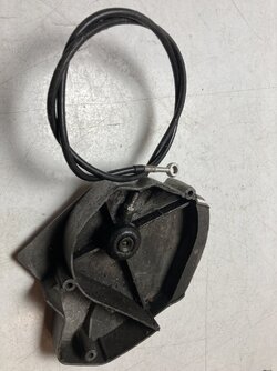

The piston, o ring, dust seal, hydraulic hose and rebuilt the master cyclinder. All are new. The orginal and new piston have been coated ones.

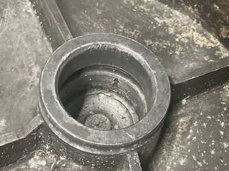

From the attached picture the internals have been damaged by others. I had to top the fluid up over the years but is was very slow leak.
The only thing stopping it leaking was the rubber from the old hose breaking down and blocked the leak.
So now it is all clean the fluid just pours over night. 30mm piston.

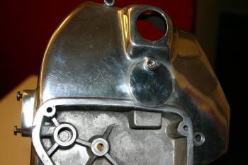

Hi Steve, i have one nice piece for you...SOLD euro. IMG_4493.JPGShipping is no problem. Kind regards Ralf

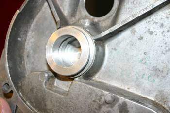

"A bit of faffing about but it could be bored to take a 31mm piston." the damage looks too deep to me Steve, best route (maybe aready sorted) is to get a used one in good condition, but for me I would bore it out, (and through) make a 30mm sleeve and shrink it in, BUT the hose connection will then need modifying to prevent the circular crack that happens on 180's, so cut off the bleed nipple arangement, weld up the hole, and fit the hose direct to the cylinder through the front. pic shows a 180 but you will get the general idea.
I reverently disagree my friend. It doesn't seem like there's any damage there that wouldn't clean up with half a mm let alone 1.
Regarding the cover requiring replacement, I wouldn't jump too quickly. There's some minor damage there, but the bore itself has almost nothing to do with keeping the fluid in - it only keeps the piston in alignment. Sealing is done by two surfaces in the groove (which we can't see other than they're dirty) and the outer diameter of the piston (which op said is new).
I'd get in there with a dental mirror and fine scotchbrite and polish till it's perfect - especially the flat face on the nearside facing the fluid cavity.
