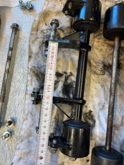

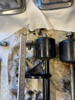

Hi Claudio
Could you do me a massive favour and show measurements from brackets to end of tubing with out the rubber mounts on them as I am trying to see if mine have been altered.
I have 61 mm left hand side and 60 on right hand side. Total length 230mm
Thanks in advance
Stephen
black tubes end to end ca 180mm
