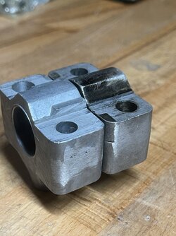

I have received all the parts from Wolfang to rebuild the cylinder head (and the rest of the engine), new valves, seats, guides, seals, thick shims and cam blocks. My blocks doesn’t look too bad but I thought it could be a good idea to start from 0 again and Wolfang told me that his NOS RGS cam blocks are far better than those I had in my original head. Once I have both in front of me I can’t say why they should be better apart from beeing new of course. i would have preferred to put the CNC ones from Red but he didn’t have them in stock, I have asked Red if he might have a set… lets see.
Now my problem. When I have tried to dummy install the new RGS blocks, they don’t fit because they have a higher “step”. So what should I do? Machine the blocks? The head? Put them in the “box of parts just in case someday I will need them and finally don’t”? It is worthy to change them? Are they really better?
Attached photos of both the original 1200 78’ cam blocks and the NOS RGS blocks.

For what its worth and for some extra information on the subject,I had the same issue when I had to replace 2 of the cam blocks on my 180 Jota. I was able to purchase 2 original NOS blocks from the 120 degree engine as original items for the 180 were no longer available.
As with yours these had the larger locating step for better positioning but I was able to machine them (by hand) to match the originals and thereby fit my head.
It solved my original issue as 2 of mine had previously been bushed.
With yours however when you are replacing the whole set I would have thought it was still preferable to adjust the blocks rather than the head but a more knowledgeable person might say otherwise, and you would need to confirm free running cams after replacing all blocks.
If it was me I would measure the old blocks against the new and see what differences you come up with regarding measurements and if yours are past their best then replace or reuse.

Thanks for your posts! I explained the problem to Wolfang and he said I should mill the blocks or the head, he told me he would send some photos but i haven’t yet.
Returning the blocks is not an option because i paid a lot in customs and shipping from Canada to Spain, so I would not worth it, I would preffer to resell them or keep them.
I am hesitant to modify my head because my blocks are not in bad condition.
My best choice would be the CNC blocks I guess but I haven’t source them yet.

I would mill the blocks, if it goes wrong you could buy others. If you mill the head, a new one is difficult to find and more expensive
That is for sure… i wont mill the head specially because my original blocks are still within limits. On the other hand if I don’t change them now, I will probably never do it.
The question is, are those RGS blocks somehow better than the 78’? Better aluminium? Otherwise is not worth the investment of milling them (I dont have a mill machinery at home, unfortunately)

Thanks! I read the old post, very helpful!
It looks I had already the second generation blocks that is why they were so similar to the NOS set from Wolfang. Only difference is the step that need to be milled in order to fit properly in the head slot.
So as my original ones are in good condition, I will either keep them or install the CNC if I can source them, in that case I would try to sell my set of new blocks in case somebody wants them. Is a full set of NOS blocks later type including center ones.
I don’t have a mill at home and I don’t want to pay to mill them if it is not a significant improvement in my head rebuild…🤷🏼‍♂️

Jo, that is incorrect, Miguel has the 2nd version of cam blocks that are located by the machined parallel section on the bottom of the cam blocks, his cam block version does not use the locating dowels
Miguel, you are correct that Wolfgang has supplied you with the incorrect cam blocks, they will never fit your current cylinder head without intervention by a Milling Machine by either machining the blocks (preferred choice) or milling the depth of the locating grooves in the cylinder head

So as now I know that my actual blocks are second generation and they are in good condition, I will re-use them.
I will put the new ones in the neverland box.
