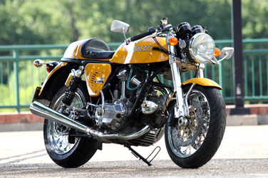

There is a bloke in Canada who ran a big bevel website for ages who had a very nice bevel that ran 17-inch wheels, In my opinion, those wheels just looked wrong as it could get. Tippie can you wack a pic of your twin up, I would love to see if it's got similar proportions to that Bevel. It had really long forks with THOSE wheels and didn't carry it well at all.

likely my buddy Rene Waters. Photos here http://www.renewaters.ca/twenty12/index.htm I can outrun that bike on any one of my three Laverda triples......:cool: ;) the bike is very non stock, uses a lot of modern parts including front end and rear suspension
he was pretty quick on a very pretty 60's Ducati 250 at the Moto Giro in Nakusp, British Columbia a few weeks ago.

Bike has a quite modern stance, Lee! Quite convinced it works just fine.
A friend fitted moderately wide 17 inchers to his 750 SFC "replica" build, together with USD forks and big brakes. Proportions were way off, despite it being a very pretty and well put together bike that tracked nicely. He eventually went back to 18", purely for the esthetics. Rode just as nice on those too.
The big gap over the rear is a bit eye-catching but the front looks ok. Here is me being picky when my 3c is far from a busty queen, great spell check change, it's supposed to say Beauty Queen. It's performance first for me.

This the bike Vince & Paul ?
His web site is still up , but he has stepped back from admin [for want of a better word]
yes, that is the bike built by Rene Waters. Rene and Sue have retired to a very small community in rural British Columbia not far from Kaslo British Columbia. His garage/shop is bevel Ducati central and the road in to their place is roughly 30 kms of some of the best twisty road in western Canada........ I'll ask Rene if I can post some bike photos I took at his place a few weeks ago
