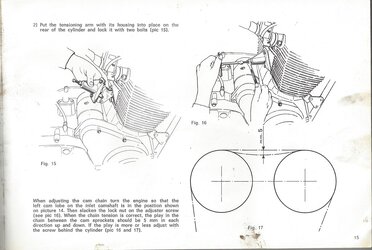

See attached and note correct tension is "5mm IN EACH DIRECTION UP AND DOWN" ie. 10mm TOTAL.
View attachment 85759View attachment 85760
Yes that’s the exact same procedure I followed 👍🏻 .
