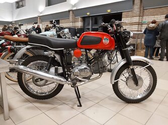

The ISDT bike has now got a younger brother for company...
