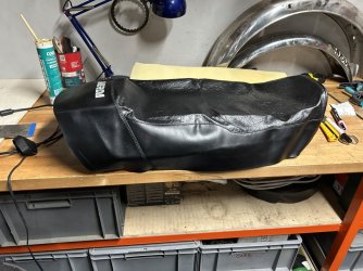

I bought over 5 cover from el Dorado, they are exceptional. I wouldnt be surprise that Jean gets them from Australia also, but good luck getting in touch with Tony Oconnor, he takes his time answering the emails, you will need some patience!🤪😇
Changing the cover needs a bit of skills, imagination and creativity. Use a good contact glue. Some pieces of thick paper to avoid marks on the cover.
I first put the cover without glue with lot of pliers, and then I glue it part by part letting it dry it before going with the next. When gluing it, i give an extra tension.
I recommend you to powdercost the base, normal lack would be damaged with the solvent of the contact glue.
Miguel
Tony of Eldorado in Australia replied really quickly, I was impressed. All paid for now, just waiting for UK Taxes to bend me over……………
