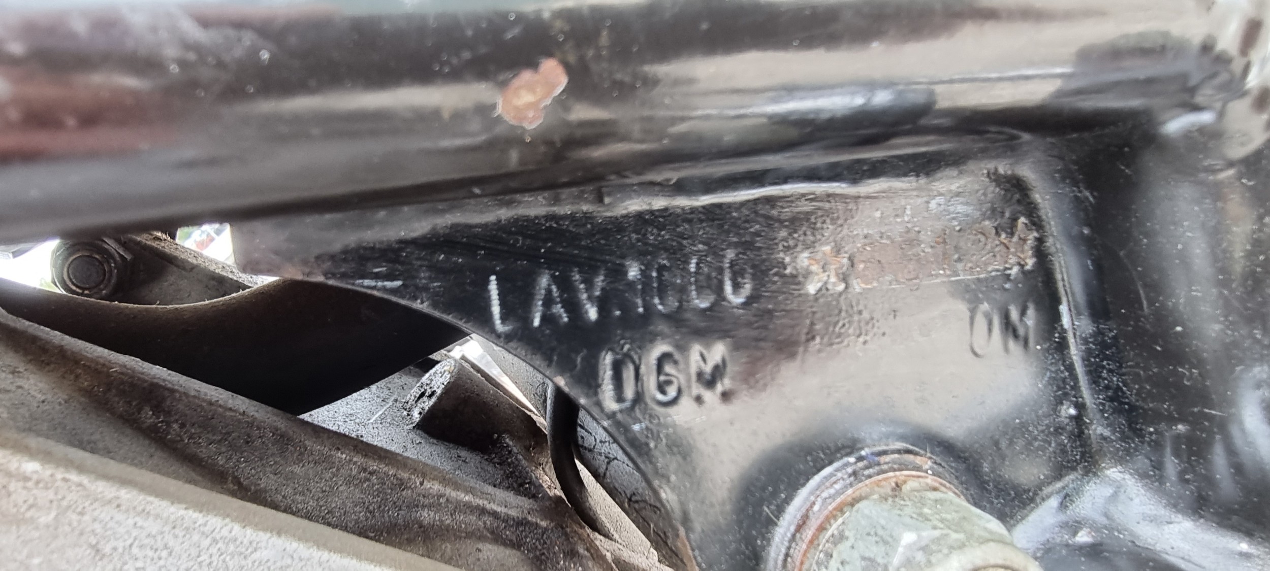

DVLA have requested some details including a photo of the frame number. But the frame has been nicely powder coated and nowt is obvious.
Where do I find the Frame number? (Angle grinder and flap wheel poised in hand).
DGM on the frame, actual frame number on the headstock, as my faultering recall would have it..... removed tank would reveal all i would think, is the case for Australian delivery Laverda. HTH J

Frame numbers on Lav were always on LH engine mount but some countries demanded that they be put up on the steering head and apparently some frames have them in both places. The prick who registered my SF2 into the database here put the DGM **** OM as "zero M". I should have done the four hour round trip to make him change it but just left it like that in the paperwork, had already had four or more inspections of the bike at traffic stations all over southern Norway because they didn't know how they could tick their boxes for a such a relic.
I think that the frame numbers moved to the steering head with the introduction of the 1200 /lay down shock frames. Seeing how the original question was in relation to a 77 Jota one could reasonably assume that the numbers would be on the lhs lower frame near the swingarm pivot.
That's not the frame number. It's the homologation or type approval number. All bikes of the same model will have the same homologation number, so it doesn't identify an individual vehicle. The frame number will be stamped somewhere else, either next to the DGM number or on the headstock.

He wanted the whole lot: LAVSF2*17424* DGM*12565*OM regardless that I told him that the OM (probably "omogata matricula") was the same for all of that model, didn't really matter. When I got into the place to pay duty the guy couldn't find it, so he tried the zero and there it was.

the number should be LAV.750 SF2*17424*
this is the number that identifies the individual bike, although tha actual identifying difits unique to this bike are only 17424
The DGM number is the type aproval for all bikes of that actual model. looks like a late '74 SF2, check to see if it has 16 fin head and 13 fin cylinder block, but (as always) may have been changed at some point.CLEM
The Number read LAV.1110 *4841* so a photo has gone off to DVLA in the effort to get a V5.
The Engine number is 4251 and the bike shows signs of being raced in the distant past so a different engine number doesn't worry me. I want a bike to use rather than polish for concourse. In the 80's I had a blue and white Jota than went rather well.
