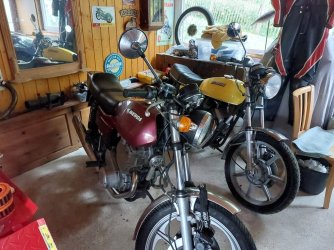

BTW, AFAIK most of the 350s were built prior to 1980, but weren’t big sellers so took time for them all to get sold, and many were converted to 500s, so getting quite rare now.
I have some spare engine parts, but most of the parts are the same as the 500, but even they are now getting harder to find.
