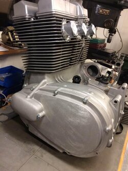

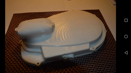

Regarding: side cover, I was allowed to borrow the original from Piero Laverda, and I had it scanned and 3D printed, plus they printed it 1.5% larger, so I had a mold, I had 6 pieces stamped at a local foundry, afterwards I set about machining it, and had tools made to machine it, I used a CNC machine to mill out the 2 needle bearings, it was an exciting project.
