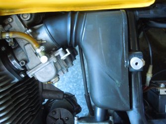

Cam,
I simply reduced the depth of the airbox to allow easy fitment of the rubbers to the Mikunis, about 10mm iIrc. Intake stubs supplied by Topham.de... I was quite happy about how easy it turned out. They are a tight fit, but nothing a dip in hot water won't cure.
No filter in the box. It's fitted mainly to significantly decrease intake roar and to prevent the rearward bit of the bike getting grubby from fuel blow-back. Reckon I'd fit some sort of filtration if I ever contemplate crossing the Nullabor or trundling up the Birdsville Track though. None of that type of landscape in my neck of the woods.

View attachment 103405View attachment 103406
Clever and yet sympathetic mod.

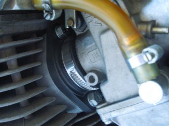

Hi Piet
You appear to have straight inlet stubs on your bike. I'm using Red's angled stubs, so my carbs sit lower and more horizontal. But I'll see if I have an airbox somewhere that I can muck about with and trial fit. It may have to sit lower down than its original position. If I can get it to fit in a position where it looks like the rubbers might have a chance of bridging the gap, I'll order a set.

My carb position is pretty odd, Doug Home molded my 3c to change its angle and position and ported the hell out of it to change the gass flow a lot plus I use rubber mounts for 40mm carbs that are a different length. My carbs stick out further so the airborne if it fitted would be much thiner.

Yes, using straight inlet stubs as supplied by Tophams, the Keihin/Mikuni concessionaire for Germany. I have no clearance issues whatsoever with either the stock "Jota" Laverda stubs nor with the Tophams items, but these offer a little more space behind the carbs by being a tad shorter than the originals, hence allowing easier fitment of the intake rubbers.
I have since abandoned the stock intake bellows in favour of tubes from a Guzzi Lemon Mk?. These have been fitted with 3D-printed adapters at the carb mouth and air box inlet. I don't have any proof of improvement but my gut feeling says anything smooth just has to be better than those rough original bellows. A sort of curved intake trumpet if you like.
