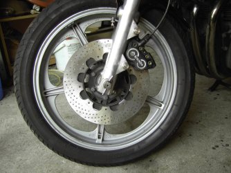

I think you will need 5mm to clear P4 calipers with std pads. only seen these with the later brembo carriers and 9 bolt disc rotors.
Are they floating or Rigidly mounted? From what a saw floaters are 5mm, that's petty thin. Floaters are almost twice the price of rigidly mounted as well. With some thinking time, floaters are very sexy but unless you're hammering the brakes to the max, and that's unlikely on the road with limited high speeds and hard braking there's probably overkill. In more than 30 years of use, I have never warped a Laverda disc anyway. The ones in use are my second set, I wore the first set out thickness-wise.
