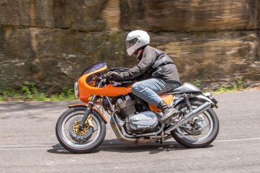

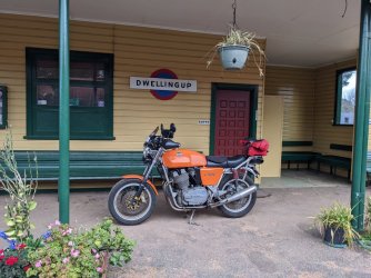

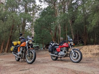

In 30 plus years, it's been a track bike, a cafe racer, a grand tourer, and now it's going to go back to looking stock-ish.
