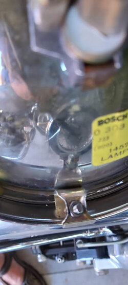

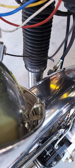

Hey Paul I think the clip sits in the chrome bezel not outside like in your picture.I had to take the clip on the bottom of the headlight rim off on my 3C to chrome the rim.
I don't know how to get it back on!
This is what I've done but it's all wrong.
PaulView attachment 57460View attachment 57461
I mislead you Paul the clip does sit outside the bezel and pulls the bezel into the headlight shellHey Paul I think the clip sits in the chrome bezel not outside like in your picture.
When you push the bezel home that clip sits over the lip on the bucket shell then pulls the bezel onto the bucket.
Thanks Maurice, I think I've understood but the light bowl needs a lot of pushing to secure.I mislead you Paul the clip does sit outside the bezel and pulls the bezel into the headlight shell
I've had this drama myself recently (on a Dramah too!) only to have it pop open and spill it's guts onto the mudguard a short time later: luckily I hadn't gone anywhere...It can take the slap of the ball of your hand on the metal rim, some pressure. Aim well, get it wrong and you can do damage. It will produce a solid CLICK when engaged.
