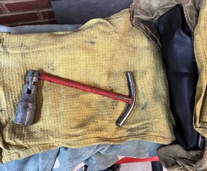

I took tank off then tried the exact plug spanner you suggested and hay presto got it out . I didn't realise middle plug is tilted to the left hand side . I was trying to come down straight on the plug
