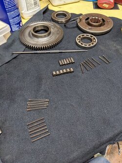

Pulled the starter clutch out of my 1974 3C today, one lazy spring. While I'm at it I will replace the bearings. Question: outer bearing, 16006, fitted without seals, ie, open bearing. Inner bearing in the cog, 16007, fitted with seals. Why? I would have thought it should have been fitted with the seals removed?
