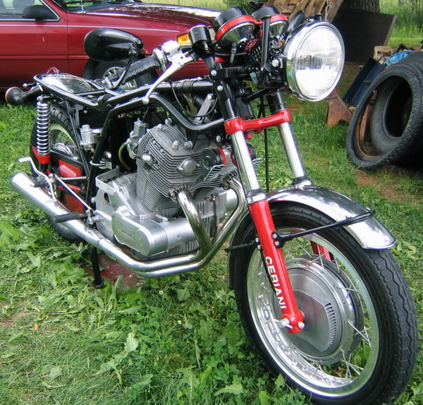

Said it before but you can use Japanese Head Light Pods (Inverted) that will accept Bosch and Lucas lamps.
If you notice head Lite rattle - Cut 3 lengths of appropriate diameter rubber tube and shim the head lite Pod - Simple ;o)
I ran an 8" 55/70 Watt Halogen Lucas Lamp in an inverted Jap Pod:
Evidently that ride has a fairing ;o)
Total: 17 1/5" wide 70 Breganzie 750 SF0, 120 mph+, with a Rickman Fairing - Note my Halogen Fog Lamps.
I going to see where I going and hopefully they will see me plus them 2 loud Fiam Horns ;o)
NOTE: I could barely keep the battery charged with all that illumination especially riding at night (Which I did a lot of). I highly suggest if you want to lite up like X-Mas tree that you look into replacing that Bosch Regulator and Generator with a GTL Alternator or some Alternator from a 4 Cyl Jap ricer car ;o)
