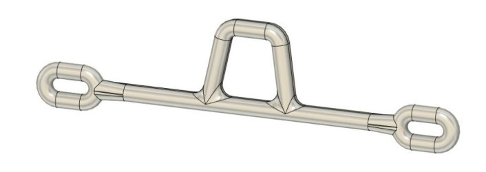

I was thinking about replacing my tank strap and as I looked at the new one I thought that they don't last long so i should model it and 3D print one for fun...:cool:.
Rather than a round section it would be flat on the bottom to address the overhang. The nice thing about tpu is that it seems really strong and of coarse it if breaks a slight design tweak and re-print.
Has anyone tried it? I will make the file available after my TPU dries and prints

Tank strap should work OK, but why bother with a round section? Hardly anybody will see it.
There is something about round that just looks better...

I will get TPU into the printer today and print a strap.
I put files up in the resource section. EDIT For some reason the strap did not print full height...almost like it only prints the top half. Further investigation required. EDIT2 I will repost when I find what the problem is

It seems there was a nut loose behind the keyboard... files have been reposted

Thank you, I made one in TPU from your design and it's an excellent fit on early triple.
For the twins, given the very little stretch in TPU, it's very hard to get onto the pins - first is easy enough but the second is a struggle given the little space between pin and frame tube, so I'm going to try making it a little longer and thinner.
