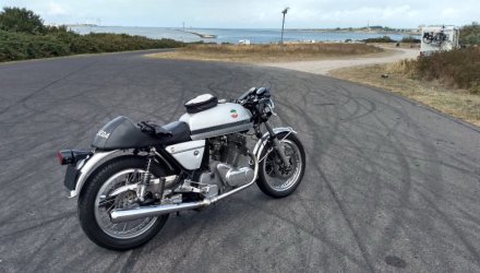

I bumped into a very pleasant gent from the Netherlands (and his lovely family) at the 2024 Breganze rally. (If you're reading this Sock, they sat with us for lunch when you kindly blagged some food for me!!)
This is his SF2 with BMW sourced (GS1150 or 1200) twin pot calipers fitted. He said it just needs two 5mm spacers on each caliper to get the spacing right on the disc. The distance between to mounting bolts is exactly the same as standard Laverda issue Brembos. He said it results in two finger braking with loads of feel.
Albeit they are supposed to be mounted behind the caliper so the smaller piston acts first but that possibly/allegedly/perhaps makes no discernable difference.

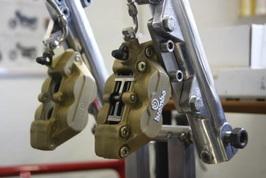

Same as on mine, Chris.

Hi Chris! Thank you for your compliment and best regards from my father. Small correction, the frame indicates sf2 but it came from the factory as a sf3. Now converted to spoke wheels with 3 discs. He’s really enjoying the calipers and a lot less dust collecting around the pistons. He said even one finger braking😉. Did you already install them as well on your project?

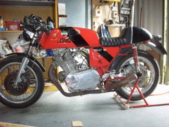

Ciao!! Mine are ready - overhauled with new parts throughout - but the '74 3C still has a long way to go!!
