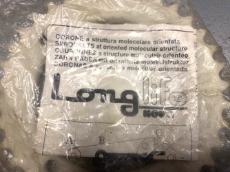

... here we have a "long life" sprocket made out of Novalon by NAVA in original unopened packing - 36 tooth for reaching 250 km/h on your triple ;)
Ciao, Gert
