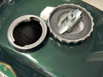

Mine had same leaking problem, so I used 1,5 mm thick viton rubber sheet on my S tank. Why 1,5 mm? Because I had it..🙂
Didn’t cure the leaking completely, until I noticed that the edge of the filler neck was slightly dented. I carefully removed the dents in the ,quite thin, steel, now it doesn’t leak anymore.
Marnix
