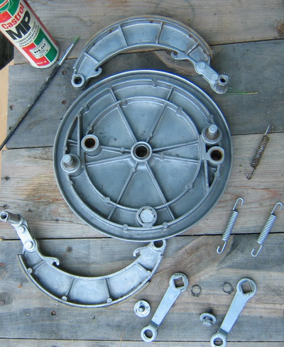

SF"C": Mechanical BREV Double Leading Shoe Drum Brake.
Rear BREV Drum Brake:
Front BREV Drum Brake:
They are so easy to work on and adjusting; other then loss of skin polishing them, they never wear out including the brake pads plus they handle rain better then disks. Haul you down from 130mph time and time again without fading.
If you don't service them about every 3 years they do tend to gum up with dirt.
