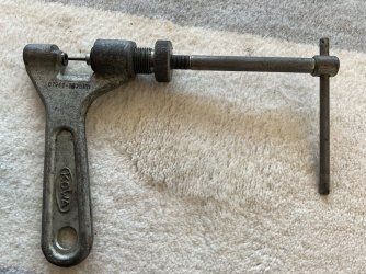

Honda don’t use master link, just endless but do supply a cam chain breaking tool to push out a pin and replace after.
Simply begging for disaster...
Chain pins are rivetted/peened over at their ends, when pushed through the side plate they will compromise fit if re-used.
It is strongly recommended a new connecting link be used. I'm certain if Honda offered such a tool, they would have offered new links to suit.
They did- it was called a soft linkhonda

Thats a soft link, no clip involved but must be peined over - pic is of genuine Honda tool for pushing out the pin, made by Kowa as most Honda tools were. I’m not making it up, I was Honda factory trained at Chiswick and worked in Honda 5 star dealership for 11 years going from apprentice to workshop manager. Never had a cam chain fail, fitted hundreds using this exact tool, How it’s ended up in my tool box is a mystery?
