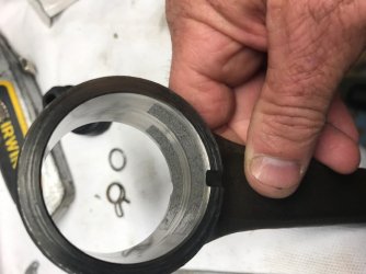

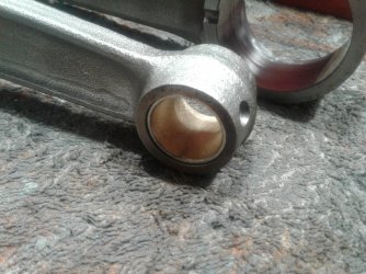

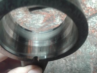

For those that have never seen the insides of a Laverda crank... big end and crank pin showing first signs of giving up.  Slight grooving in the centre from bearing cages.  Pins and rods scrap.
This damage cannot be detected without crank disassembly, everything feels fine outwardly.  This particular SF2 crank would have easily done another 10,000km before making really bad noises, but, by then, there would have been seriously large bits of steel floating around the engine, with further wear and tear resulting elsewhere.
I'm always sceptical when an owner tells me he's done a "full engine rebuild" without crank disassembly.  "It was fine..."  For how long? :D

Same crank, with new oversize crank pins and reconditioned OE rods.
Piet
