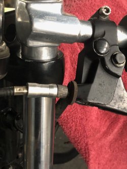

I’ve fitted a slightly higher set of bars to the SF1, not as tall as GTL bars but taller than standard SF1. The standard SF1 front brake cable is a bit too short to fit, so I have a cable I bought for the GTL I’m refurbing, but find that the amount if exposed inner cable is about 2cm longer than that of the SF1 cable. See photo. Has anyone got a good solution for fitting something over the cable to take up the slack as it were?

Bear in mind that the GTL uses different handlebar switches (ND) with a separate brake lever clamp, differing from the Lucas integrated switch and lever pivot on the SF so the length of inner cable accounts for the different handlebar gear.
I suggest you should keep the cable as is for your GTL project and look for the longer length cable to fit Lucas levers as would have been on the GTF model of the same year as your SF which used same brake, same handlebar fittings, etc. but to fit the higher GT bar.
There are vids showing how to cut off the existing end nipple and adding a new one after shortening the cable. Or else order a proper length cable from Venhill
Thanks Teddy. Don’t think I could trust a cable where I’d moved the nipple. I’ve dropped Venhill a message, they haven’t got one on their website I could find, they might be able to knock one out.

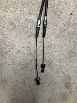

I made a cable freeplay reducer as pictured. This to enable use of an R1 clutch cable on a light clutch SF, but the principle is the same as would be required for your brake cable. No cutting cables and risking failure - if nec you could fit one at each end to double the reduction. (The slot for fitting over the cable is on the far side.)
I’ve borrowed PB’s solution, less gracefully. I removed the adjuster from a spare handlebar lever/mount and slotted that in at the lower end above the adjuster for exposed cable length. It’ll do for now. Venhill will make up custom cables so I’ll send the old cable off and ask them to make a couple with same exposed length but overall length at 125cm.

In fitting the higher bars to the SF1 I ended up having to use all the longer cables I’d bought earlier in the year for the GTL refurb. But I found that the front brake, upper throttle and upper choke all had a few cm additional length in their exposed cables, so bodges to all were necessary. Luckily I have the 50 year old GTL cables which I will take to JJ cables and get a set for each bike and a spare set made up.
