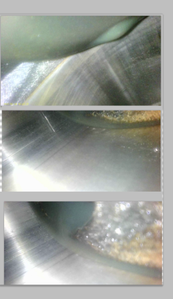

Thanks Piranha and an update:
A boroscope shows the nice cross hatching from the rebore, but there’s a series of @1” wide black wear marks/vertical scratches that are on both cylinders, aligning with the front and back sections of the pistons that have indents on the top.
During assembly I staggered the open gaps of the rings and the machinist fitted the rings and attached them to the pistons, and I’m assuming he didn’t flop them.
A mechanic friend will look at the boroscope and give me advice on whether to leave as is, or take the motor apart for hopefully just a rehoning.
So any thoughts on what could be causing these marks- I’ll post pics shortly, thanks
It's difficult to clearly see the marks from this boroscope, but they are on the front and back sides of both cylinders. A mechanic friend looked w the scope and feels that some of the scratches are too deep for a rehoning, so now larger pistons and a rebore will probably be needed. Since the marks and scratches are fore and aft, it seems to indicate that the clearances were too tight once the forged pistons expanded w heat, and began binding as the pistons slightly rotate on the pins during operating cycles.
Again, new .5 over Ross Racing forged pistons w new rings, pins, and circlips were installed, and the engine has run @ 2K miles.
So now I have to find a better machinist stateside. Wolfgang recommended the Ross racing pistons but what do others use?

From what I can see those marks should clean up with honing - and increase your clearance (although honing would take forever to increase clearance to any degree) - f they are indeed deemed too tight. But I'm no expert in reading bores. Ross Racing pistons in my 880 hi-comp and no problems whatsoever. Pretty sure Redax use them almost exclusively.
