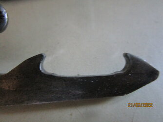

The arm hook that pulls round the selector spindle looks fine to me,and the spring ?.
Suppose as the arm/hook is a moving part and could wear. Even the eccentric screw
looks ok. Selector drum shaft and selector spindle marks line up perfectly. Are there
documented wear limits ?

Closer inspection, Now that does look worn !. Could anyone post a pic to compere ?

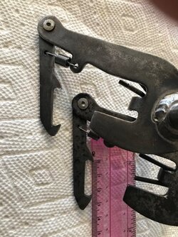

These are two well-used but still serviceable units that I intend to reinstall - the inner section is straight where yours looks curved and the hooks appear sharper though I can't say that either of those factors would lead to the problems you're having.
If you could describe what the specific issue with shifting is it may help come up with a reasonable diagnosis - there are many varieties of 'shift problems'. As for the hooks - an accurate measurement with a vernier between the internal edges of yours and a known working one will indicate if there's a possible link there - as long as the hook moves the selector pins far enough to allow the internal roller to click into the shift drum indents then that is not your problem.
