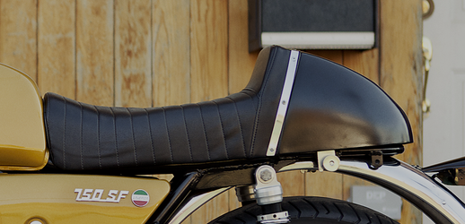

the earlier seats with the storage in the back (bread box seats here is AUS) are slightly different to the later seats as used on the SF2's and some 73 SF1's. The dimensions are different and the shape of the container is slightly different. The chrome trim around the rear section/upholstery interface is in front of the rear shock top mounting bolt, not behind as on later seats.
From experience, you also need to be wary that some reproductions seats for the first model SF's (as per Ernesto's photo) do not line up properly with the mounting tabs on the frame.
