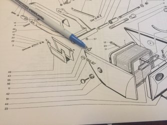

750sf3 Rubber Bits
Otherwise, your local do it yourself shop will have plenty of different rubber bungs for furniture feet, door stops, etc...
No Laverda could do without them.
I like your way of highlighting the part you search for in your picture, I am not clever enough to work out how you draw an orange circle around a part and then post it.
I need x2 Piet,
I have tried a cut off piece of rubber hose which seems to work, but was after the real deal.
Clem, I did circle the item, in a pic I had, but didn't stand out as well so went with the old pen pointer  :)
