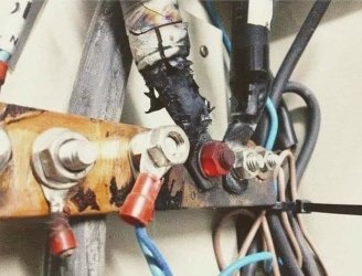

I got over my recent anxiety, I replaced the lot using the local bike rewiring bloke. Expensive but well worth it for that nice warm feeling.
If I ever see one of those plastic shielded generic auto shop crimp connectors on a bike I'm working on I immediately grab the cutters, wire strippers and pro crimpers, and finally, decent brass connectors that crimp the wire AND the insulation. Then silicone insulation shrouds or shrink tubing (with a hair dryer ... to quote Frank Zappa's central skerrrrutinizer ... again).
