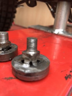

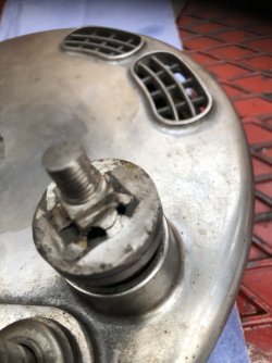

BSA conical hub, stainless levers, all nice and shiny….mate of mines bike, I noticed the levers were at an odd angle and suggested it may be worn shoes and needed a look. Someone has made “ adapters” for the stainless levers and they were all but hidden behind stainless washers and dome nuts.
The weld has cracked on two corners of each of them- can’t believe how bad these things are or who thought it was ok to make/fit them. Caught them just in time.
