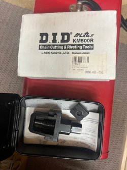

Couldn't find availability in that length, so I got a 108 and shortened it, with a DID KM500R, as it was too much of a struggle for my old Whale breaker.
The 500R is a well made piece of kit and does a good job (see photos), not cheap though.

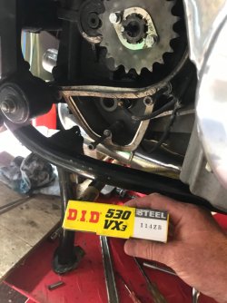

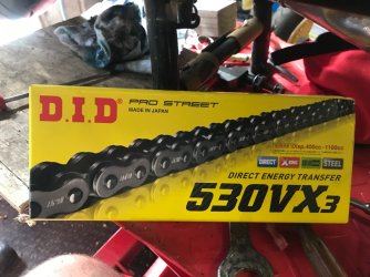

Similar DID chain (VX3) but 520 on the SFQ - 14,000km and have hardly adjusted it, handling a lot more ponies than a stock SF. Also have the KMR500 - strong as buggery but not super easy to use. I end up grinding the pins back when shortening the new chain. And I cheat and use a split link - I have to use the tool to press the plate on before I can get the spring clip on so doubt I'll have any issues with it going AWOL.
