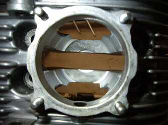

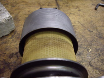

I think these engines are quite sensitive concerning oil supply. I made some meassurements concerning oil supply to the head and found that with oil (10W40) at minimum level at 20°C above 2800 rpm the oil support broke down completely. At max level under same conditions and 6000 rpm there were a lot of air bubbles to be seen in the oil flowing back down. So riding an Lav 500 I would at least keep an eye on allways having oil level at max. For the use of an larger oil pump I modified the oilfilter with a cap.

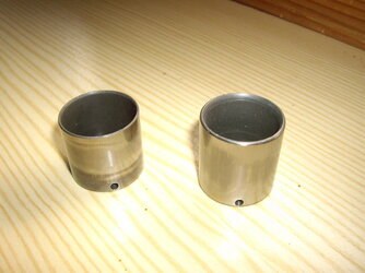

OCT sells the Tapets on the left side ( lenght 23 mm, 19.1 g) they worke very well.
original 26mm, 30,7 g
