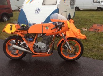

Are you racing? I still have a blanking plate to cover the hole removal of the starter reveals. Also I have a replacement R/H Side cover machined from billet which covers the end of the crank when you remove the alternator for racing.IMG_2130.jpeg
