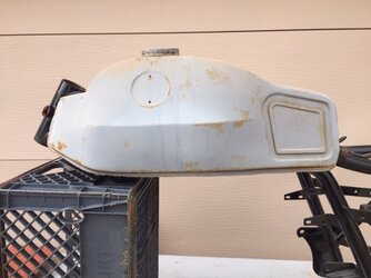

I'm assuming he's talking about one of these - the first pic, black. The second S and third SF tanks fit just fine onto the S frame 26xx underneath them all.
Agreed that S and GT tanks not easily interchangeable as the GT frame is wider by about one inch (=25.4mm Paul!) at the rear of the tank.

That said, all the AE plastic tanks I have seen show evidence of rubbing on the top frame rails and need to be held higher with a couple of the rear cushions as they are not a perfect fit on the S frame. The steel tanks have a slightly arched underside profile to stand clear of the frame where the plastic tanks are almost flat.
