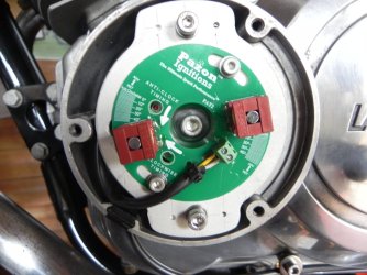

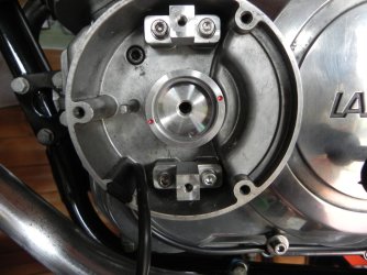

Also as a side project I have designed / made the parts to fit Pazon ignition, considerably simpler than the original Bosch setup which seemed over complex.
Based on lost spark - one magnet on rotor - two emitters with double output coil.
original system had full advance at 3,000 rpm - which seems low on a bike that can rev to over 8,000
