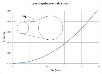

Andychain (who used to post here) seemed to be quite knowledgeable about chains. His rule of thumb about replacing chains was that if the chain stretch was less than 1% it was OK to remain in service. I've never seen anything like 1% stretch on a Laverda primary chain, although I've only worked on a few. Guys like Piet who work on these bike all the time have probably seen some way worse examples.
Some time ago I calculated the relationship between chain stretch and the deflection at mid-span for a Laverda primary drive. I've attached it below as a chart. The datum used (for 0% elongation) is the calculated length of chain pitch multiplied by the number of links. If your chain has more than about 20mm sag (when pressed mid-span), it's time to start thinking about replacement. If you want to be more conservative, that's your choice. Just remember that even a brand new chain may have something like 5 to 10 mm sag from the theoretical length because of the cumulative effect of the small clearance between the pins and bushes.
I don't remember the recommended km between chain replacements, but I'm not too bothered about it. Basing maintenance decisions on measurable physical properties seems more logical to me than an arbitrary odometer reading or a date on the calendar. The distance travelled method doesn't account for how hard the engine has worked. For a given distance travelled, there would be a big difference in chain wear between a bike that's been flogged on a race track and one that's just been used to tootle around town on. A specified km limit therefore has to err on the side of caution and assume the bike has had a hard life, which most bikes don't.
As an example, my brother's 3C has done over 100,000km and still has the original regina primary chain which only has a fraction of the 1% stretch limit.

PS: I acknowledge that some chains have been known to break before they reach the 1% elongation. But I suspect most of those would have had some kind of inherent fault. The problem with chains is the weakest link theory. A roller chain is made up from a lot of components. I can count 24 components for each link pair of a Laverda triplex primary chain. There are 38 pairs of links (76 pitches), so 912 individual parts in the entire chain. If only one of those parts has a defect or a has not been fitted together properly, the chain could fail. Unfortunately there's no way to tell if there's a hidden defect lurking in your bit of chain. Such things are generally only found during a post-mortem of a busted chain. So there's no chain replacement regime that can protect against that kind of spontaneous failure. It can be logically argued that a known used chain that's still within its wear limit is less of a risk than a brand new chain, because you can be pretty confident that the proven chain has no weak links. Whereas the new chain is unknown.
Fortunately the quality control of reputable brand chains is pretty good, and such failures are rare.
