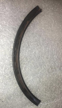

Just wondering if anyone has got one of these please? It's part number 22810351 67
Here's a picture of what's left of mine.
That is enough if it sits properly in the slot. The bearing clamps firmly in the cases and this just prevents it moving sideways. Lots of motors just have a pin to do the job. New bearings of that type generally have the almost entire circumference snap ring on them, which can be cut to desired size in this application.
