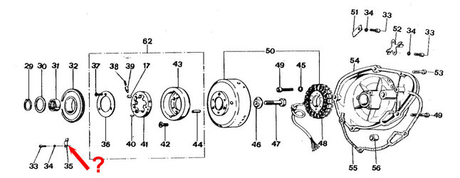

A diagram might help to understand.
Which starter gear are you talking about?
I've taken up Alan's very generous offer but would still like to know the part # if possible. Those of you who know me might remember I have an RGA and RGS (both worn out and being repaired) and I don't think these little blades (correctly identified by Craig) are in the pile of bits.

#61 933 400

The freewheel stands still most of the time, the blade is to prevent the freewheel to tilt/wander too far off and rub against the starter clutch body. Not reccommended to omit.

61 933 400.
Described as:
Piastrina spalla mento ingr. ruota lib.
Or, if you prefer:
Plate, free wheel gear spindle.
And all illustrated on parts book page. 'Albero Motore- Crankshaft'.

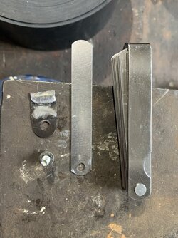

You got me thinking about this. A thick blade from a set of feeler gauges would do quite well. Carbon steel not stainless.
You could also use a hacksaw blade with the teeth ground off - i use industrial hacksaw blades and demolition saw blades sharpened and teeth ground off as scrapers and wedges.
Most hacksaw blades (for hand hacksaws) these days only have the toothed edge hardened. The back half of the blade is left ductile as a safety measure to prevent blade breakages - so the blade doesn't snap in half and poke a hole through the veins in your wrist. Try breaking a hacksaw blade and you'll see what I mean. It'll only snap half way through.
You'd have to apply a heat treatment to harden the whole blade if you want to make a springy thing out of it. You'll probably have to anneal it to drill the hole, so will have to re-harden it anyway.
There's plenty of steel annealing/hardening recipes on internet.
Personally, if I was remaking a part like that, I think I would look at using a much bigger piece of material, so it would last longer.
That original tab looks like something created quickly to fix a problem that hadn’t been envisaged originally.
