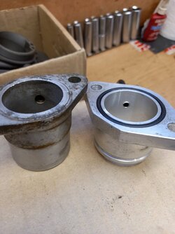

I've got some replacement carbs for my SF1 that need a different manifold.
There's a huge difference in diameter of the balance pipe. One hole measures barely 2mm the other is a generous 4.5mm. That's over 5 times the area.
Thoughts please?
I doubt it will make any difference - never actually understood what the tube is supposed to do. I reckon you could blank each one off and notice no change. I sed mine once to connect vacuum gauges. Don't use them any more either. What carbs are you fitting?

Dellortos. I got them lightly used and slightly abused

Well, you can drill and tap the intakes before mounting for some larger take offs.
Or leave as is and do it later if you can across carb setup problems you attribute to the diameter.
Or if you use a depression instrument to balance the carbs and that the depression is insufficient.

it's actually pretty tricky to drill them larger because the hole is flush up against the flange so I'm going to need some serious 'motivation' to do so as it's a mill and job and possibly a custom fitting on the lathe.
Size of the vacuum take-offs is absolutely irrelevant, as long as they're both the same for carb balancing purposes (depending on the sensetivity of the vacuum equipement involved). For anything else, it don't matter...
If the connection actually balances anything at idling is largely theoretical. The hose connection between the two is more practical than seperate caps imho.
